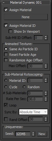

Interface
The user interface appears in the parameters panel, on the right side of the Particle View dialog.
Note: The radio buttons on the Material Dynamic rollout let you assign Material IDs to particles in several different ways, depending on whether you're using an animated texture or a compound material. Default=Same As Particle ID.
Assign Material
When on, the operator assigns the specified material (see next parameter) to the particles. Default=on.
[button]
Use this button to assign a material to the operator. Click the button and then use the Material/Map Browser to choose the material. Alternatively, drag the material from a Material Editor sample slot to the button.
After you assign a material to the operator, its name appears on the button.
Assign Material ID
When on, the operator defines a material ID number for each particle. Default=on.
In general, this should remain on. Particle Flow uses the material ID with the Particle Age map to find the particle's other properties, including its life span and current age. And it uses the material ID with compound materials to know which sub-material to assign to a particle.
Show In Viewport
When on, the material is shown applied to the particles in the viewports when the particles are displayed as geometry.
Sub-Mtl ID Offset
When using material inheritance with a Multi/Sub-Object material, the Material Dynamic operator adds this value to the Material ID value to create a sub-material ID. Particle Flow uses this ID to determine which of the material's sub-materials to inherit and thus apply to the particles in its event, based on the sub-material ID in the material.
Animated Texture group
Same As Particle ID
Assigns the same material ID to a particle as its particle ID. Choose this when using a material containing an animated texture, such as a Bitmap, Particle Age, or Particle MBlur map.
Note: Particle Flow assigns Particle IDs consecutively to particles at birth, starting with 0. Although the highest possible Particle ID is over 2,000,000,000, the highest possible material ID is 65535. Thereafter, the numbering sequence starts again at 0. Thus, when using a Particle Age map in a material assigned to the Material Dynamic operator, for best results, use a total of 65,536 particles or fewer.
Reset Particle Age
When on, sets each particle's age to 0 when it enters the event.
When using an animated material with a Bitmap map, turn this on to ensure that the animation always plays from the first frame.
Randomize Age Offset
When on, Particle Flow varies the difference between the particle age and the starting material ID at random. The maximum difference is determined by the Max Offset parameter.
Max Offset
The maximum number of frames by which Particle Flow can randomly vary particle age.
Sub-Material Rotoscoping group
These settings let you choose the basis on which the operator changes material ID assignments when using a compound material such as Multi/Sub-Object, and specify the rate of change.
Material ID
Assigns the same material ID to all particles. Use the numeric field to set the ID value.
Cycle
Assigns each particle a material ID in the range 1 to N, where N=# Sub-Materials, in increasing sequential order. The first ID assigned is 1, then 2, continuing to increment each by 1 until N; then 1 again, and so on.
Random
Assigns each particle a random material ID in the range 1 to N, where N=# Sub-Materials.
# Sub-Materials
The highest ID number assigned to particles using the Cycle or Random option.
In general, set this to the same number of sub-materials in the Multi/Sub-Object material. If you set it to a smaller number, the operator will use only that many sub-materials, starting with the first and counting upward.
Note: 3ds Max automatically sets this value to the number of sub-materials in the material, once only, the first time you apply the material to the operator. Any subsequent changes in the material itself, or applying a different material to the operator, will not change or update the setting.
Rate Per Sec[ond]
Sets the number of times per second that the assigned material ID is incremented. If this value is the same as the rate at which particles enter the event, then one ID is assigned per particle. If it's lower, then multiple particles are given the same ID, or if it's higher, then Particle Flow increments the assigned ID faster than 1 per particle.
For instance, if particles enter the event at intervals of 1/60 of a second, and Per Second=30, then each pair of particles will be assigned the same ID. Or if particles enter the event at intervals of 1/15 of a second, and Per Second=30, then the ID is incremented (or changed randomly) twice per particle.
Loop
When on, and the last ID has been assigned, Particle Flow loops back around to the first ID and continues the cycle. When off, Particle Flow assigns the last cycle ID to all subsequent particles. Available only with the Cycle assignment method. Default=off.
For example, say you want the first eight particles that enter the event to use different materials, and all subsequent particles to use a ninth material. To do so, you would create a nine-sub-material Multi/Sub-Object material and assign it to the Material Dynamic operator. Choose the Cycle assignment method, and set # Sub-Materials=9. Set the Rate Per Sec value to the rate at which particles enter the event. Lastly, turn off Loop.
Sync By
Choose the time frame for applying animated parameters. Available only with the Material ID and Cycle options.
  • Absolute Time Any keys set for parameters are applied at the actual frames for which they're set.
  • Particle Age Any keys set for parameters are applied at the corresponding frames of each particle's existence.
  • Event Duration Any keys set for parameters are applied to each particle starting when it first enters the event.
Rand Offset
When on, Particle Flow varies the difference between the particle age and the assigned material ID at random. The maximum difference is determined by the numeric parameter. Available only with the Material ID and Cycle options.
Uniqueness group
The Uniqueness setting varies the sequence of assigned IDs with the Random option, and the offset with the Randomize Age Offset option.
Seed
Specifies a randomization value.
New
Calculates a new seed using a randomization formula.
