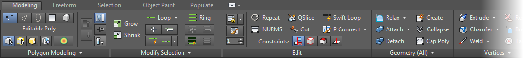

  • To dock the ribbon to the top, bottom, or left or right side of the program interface, drag it to the desired location and, when the mouse cursor changes to a horizontal strip, release it. This applies whether the ribbon is floating or docked.
    Tip: To dock the ribbon to its default location—the left side of the command panel—first maximize the ribbon, then drag it to the desired location.
    Alternatively, if the ribbon is floating, right-click the title bar and choose the desired docking location from the Dock submenu. If the ribbon is docked, right-click the left end (horizontal) or top end (vertical) and choose the desired location from the Dock submenu.

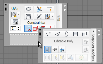

  • To dock a panel to a floating panel or panel group, drag the first to the others until a “landing zone” (rectangular outline, as shown in the illustration) appears on the target, and then release the mouse button.
    Docking one floating panel to another
    Thereafter you can move the panel group as a unit.

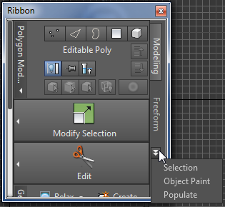

  • When the ribbon floats and has been reduced in size so that not all tab labels fit, the remaining tabs are available from a drop-down list that opens by clicking a double-arrow button:

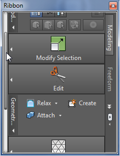

  • When the ribbon floats, you can resize it both horizontally and vertically by dragging a vertical or horizontal edge, respectively. When you reduce the vertical ribbon height, the panel contents scale as much as possible; thereafter, a scroll bar becomes available for scrolling through the panels.
    Vertical ribbon with scroll bar on left side

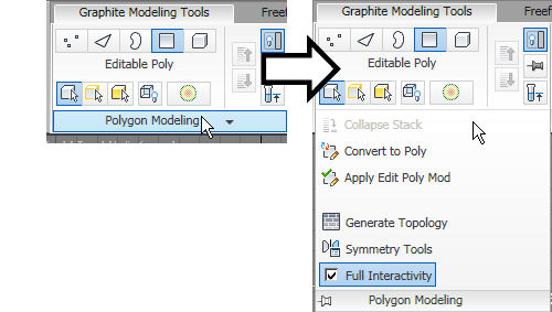

[open panel expansion]
At the bottom or right side of every panel is the title bar; if Show Panel Titles is off, a thin bar takes its place. If the title bar contains a small arrowhead, that means it can be expanded to show additional controls. To expand the panel, click the title.
The panel expansion remains open as long the mouse cursor stays on it. To close it, simply move the mouse away.
Left: Click the panel title bar ...
Right: ... to open the panel expansion.
Note: When the ribbon is minimized to panel titles, panels expand fully when opened, so further expansion is inapplicable.
Tip: If you like, you can “pin” open a panel expansion (see following).

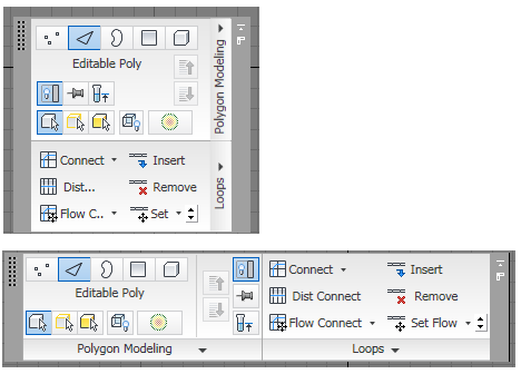

Toggle Orientation
Switches the panel group layout between vertical and horizontal. Available only on floating panels.
Top: Floating panel group in vertical orientation
Bottom: Floating panel group in horizontal orientation
