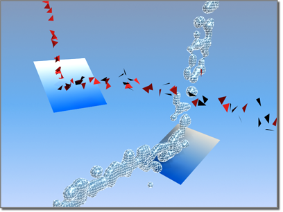

Two streams of particles striking two deflectors
