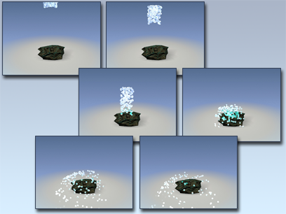

The UDeflector is a universal deflector that lets you use any object as a particle deflector.
Particles scatter when they strike a UDeflector object
