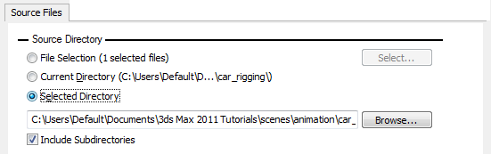

On the Source Files panel, you choose which files to optimize.
For options on how to save the optimized files, see Batch Optimization: Optimized Files Panel.
Interface
- File Selection Lets you choose one or more files to optimize. (The default is the current scene.)
Select Click to open a file selector that lets you choose the file or files to optimize.
- Current Directory (The default.) Batch optimizes all the eligible files (MAX or OBJ files) in the current directory.
- Selected Directory Batch optimizes all the eligible files (MAX or OBJ files) in the selected directory.
Browse Click to display a directory browser that lets you choose the directory to process.
- Include Subdirectories
When on, ProOptimizer scans subdirectories and batch processes the eligible files in them. When off, it processes only files in the specified directory (the root). Default=on.
This option is disabled when File Selection is active.
