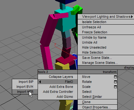

You can import HTR and BVH motion-capture files into CAT using the same method. The respective importer opens the file as a hierarchy of Box primitives with keyframes. You use the Capture Animation tool to map this motion onto your CATRig.
  • Right-click a bone in a CATRig. > Tools2 quadrant > FileIO > Import HTR/Import BVH
  • Select CATParent. > Motion panel > Clip Manager rollout > Clip mode > Click Load button. > Set Files of Type to MotionAnalysis HTR(*.htr) or BioVision BVH(*.bvh).

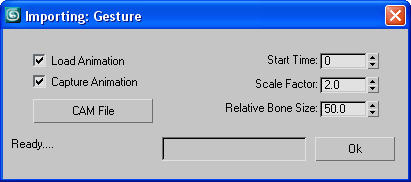

Load Animation:
When on, imports the full animation. When off, imports only the base pose in the motion-capture file.
Capture Animation
When on, automatically captures the animation, overlaying the new bones onto the CATRig. When off, imports the animation onto a new set of bones without affecting the CATRig.
CAM File
Click to pick a CAM file if you have already created one.
Start Time
The frame at which the imported animation begins.
Scale Factor
The scaling applied to the imported hierarchy when it is created.
Relative Bones Size
The size of the bones created upon importing.
