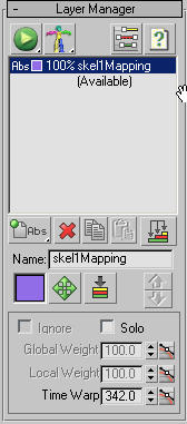

Once you have begun the mapping process, you will notice that a new layer has been added to the bottom of your CATRigs layer list. This layer uses special controllers that hold 3ds Max animation constraints. It also stores the offset, and can scale the transferred motion to fit smaller characters.

- Check the Layer Manager rollout on the Motion panel.
It contains a mapping layer created by Auto Map.

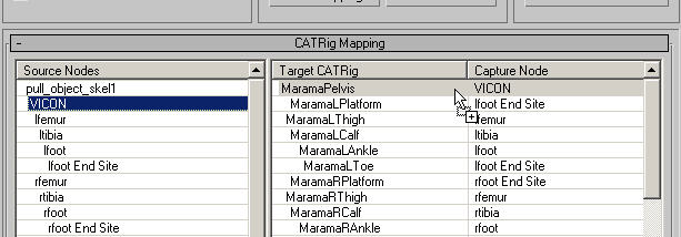

- From the Source Nodes list, drag a bone to map to the comparable item in the Target CATRig list. For example, you would drag a source pelvis bone to the CATRig pelvis bone.
After you release the mouse button, the source bone name appears in the Capture Node list next to the target bone to which it’s mapped.

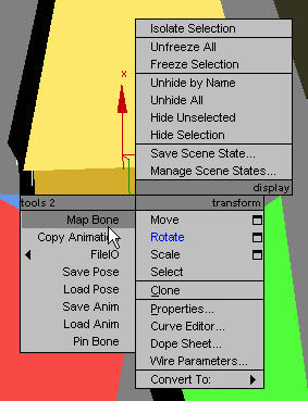

- Select the target bone to map to, right-click it, and from the Tools 2 quadrant, choose Map Bone. Then click the source bone to map to.
The Map Bone quad menu command appears only after you’ve mapped at least one bone using the manual method (see preceding).

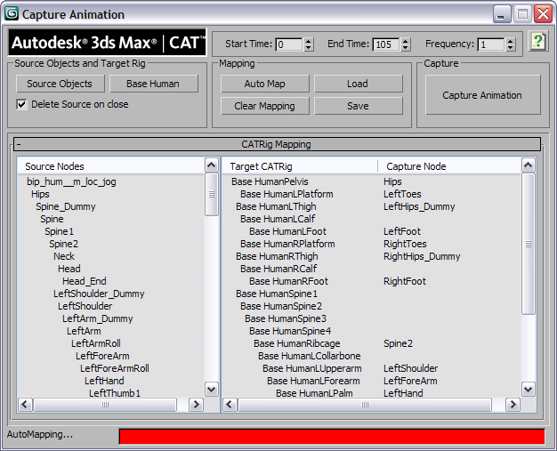

- Source Objects
Click to choose the hierarchy from which to capture animation. During motion-capture import this is the hierarchy created from the motion-capture data and the objects are selected automatically.
When you use Capture Animation as a utility, rather than as part of the importation process, the button label is replaced by the name of the root node of the hierarchy.
- Target Rig
Click to choose the CATRig to which to map the animation. When the Capture Animation utility is called as part of the import process, the Target Rig is the rig you are capturing onto, so it is selected automatically.
- Delete Source on Close
When on and you exit Capture Animation, a small dialog appears asking whether to delete the source hierarchy and remove the mapping layer. Click Yes to do so, or No to keep both.
- Start Time/End Time
The first and last frames of the capture.
- Frequency
Determines the number of frames per created key. For example: 1 = one key per frame; 2 = one key every second frame.
- Auto Map
Generates an approximate mapping of your data onto the CATrig.
Automatic mapping is done automatically when importing motion-capture data via CAT. You need to click this button only if you’re using Capture Animation as a utility, or have changed or cleared the mapping and want to restore the automatic mapping.
- Load
Click to load a mapping arrangement, saved in a CAM file (see Save, following).
- Clear Mapping
Removes the current mapping.
- Save
Saves the current mapping for reuse as a CAM file.
When you save mapping as a CAM file you can avoid reconfiguring the mapping every time you capture.
- Capture Animation
Creates keyframes in the frame range specified by the Start and End Time values. Capturing animation bakes the live mapping onto keyframes on the CATRig.
Available only after components in the Source Nodes and Target CATRig lists have been mapped to each other.
CATRig Mapping rollout
The CATRig Mapping rollout comprises two independently scrolling lists.
To map rig components manually, drag an item from the Source Nodes list to the corresponding item in the Target CATRig list (for instance, Pelvis to Pelvis). Thereafter, the source node appears in the Capture Node list next to the CATRig node to which it is assigned.
Alternatively, the software can perform the mapping automatically when importing motion-capture data via CAT or after importing motion-capture data with the 3ds Max Import function; see Procedures for details.
- Source Nodes
Lists the hierarchy from which you’re capturing animation. Populate this list by clicking the Source Objects button.
- Target CATRig
Lists the hierarchy to which the captured animation is transferred.
- Capture Node
Shows the Source Node list item, if any, whose animation is to be transferred to the corresponding CATRig hierarchy member.
