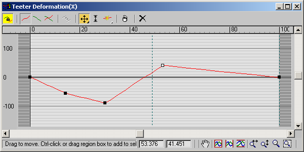

The Deformation dialogs for Scale, Twist, Teeter, Bevel, and Fit use the same basic layout.
The buttons in the window's toolbar and prompt area perform the following functions:
- Change deformation curve display.
- Edit control points (these can be animated).
- Navigate the Deformation dialog.
Editing Deformation Curves
A deformation curve starts as a straight line using a constant value. To produce more elaborate curves, you insert control points and change their properties.
Use the buttons in the center of the Deformation dialog toolbar to insert and change deformation curve control points (see Interface, later in this topic).

- Display X Axis / Y Axis / XY Axes
You can display one or both deformation curves using the curve display buttons near the upper-left corner of the Deformation dialog.
Turn on the following buttons to display deformation curves:
Display X Axis Displays only the X axis deformation curve in red. -
Display Y Axis Displays only the Y axis deformation curve in green. -
Display XY Axes Displays X axis and Y axis deformation curves together, each using its own color.

- Move Control Points
This flyout contains three buttons for moving control points and Bezier handles:
Move Control Point Changes the amount of deformation (vertical movement) and the location of the deformation (horizontal movement). -
Move Vertical Changes the amount of deformation without changing the location. -
Move Horizontal Changes the location of the deformation without changing the amount.
If one control point is selected, you can move it by entering values in the control point Position and Amount fields at the bottom of the Deformation dialog.
You cannot move end points horizontally. Intermediate control points are constrained horizontally to stay between the points on either side. The amount of horizontal constraint is determined by the control point type.
- You can move corner control points very close together, until one is directly above the other.
- You can move Bezier control points no closer than the length of their tangent handles.

Deformation grid
The area in the Deformation dialog that displays the deformation curves is called the deformation grid. This grid charts the value of the deformation along the length of the path.
These are the main grid components:
- Active area
The light-colored area of the grid defines the first and last vertex boundaries of the path. The ends of the deformation curve lie on each boundary and cannot be moved off the boundary.
- Horizontal lines
Mark deformation values on the vertical scale. The following table lists each deformation curve type and the meaning of the deformation values.
Deformation Type Deformation Value Scale Percentage Twist Rotation Angle Teeter Rotation Angle Bevel Current Units The thick horizontal line at 0 represents the deformation value at the loft path.
- Vertical lines
Mark levels of the path. The levels displayed vary with the Adaptive Path Steps setting on the Skin Parameters rollout.
If Adaptive Path Steps is on, levels are displayed at all path vertices and shape locations.
If Adaptive Path Steps is off, levels are displayed only at path vertices.
- Path ruler
Measures the length of the path. The values on the ruler measure percentage along the path. You can drag the path ruler vertically in the Deformation dialog.
- Deformation curves
You can see one or two curves in the Deformation dialog, based on the deformation type and the curve display setting. The curves are color-coded by axis.
A red curve displays deformation along the shape's local X axis. A green curve displays deformation along the shape's local Y axis.
