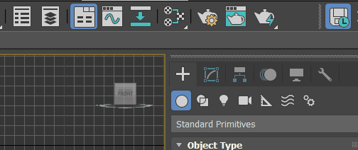

The Shader Basic Parameters rollout lets you choose the type of shader to use with a Standard material. Some additional controls affect how the material appears.
- Press M.
