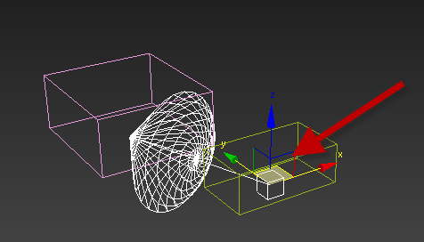

Child Attach Point
The location at which the constraint connects to the child rigid body, depicted as a wireframe cube.
When you access this sub-object level, MassFX automatically selects the Child Attach Point gizmo and activates the Move tool.
Universal constraint with Child Attach Point sub-object active. The red arrow, added for illustrative purposes, indicates the attach point.

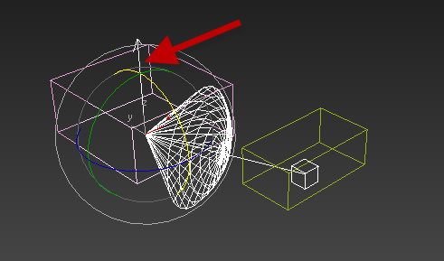

Child Initial Twist
The default center of angular motion within the constraint's limits, depicted as a wireframe arrow.
When you access this sub-object level, MassFX automatically selects the Child Initial Twist gizmo and activates the Rotate tool.
Universal constraint with Child Initial Twist sub-object (white arrow) active. The red arrow, added for illustrative purposes, indicates the Initial Twist sub-object.

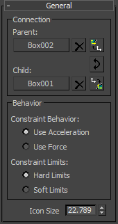

General rollout
Connection group
Use these controls to assign rigid bodies to the constraint. You can assign both parent and child objects to a constraint, or a child object only. The parent can be any rigid body type; the child must be Dynamic.
If you assign both parent and child objects, the motion of the parent (if Dynamic) is affected by the simulation and that of the child is affected by the parent motion, the constraint, and the simulation. If you assign a child object only, the child is affected by the constraint and the simulation.
You can also use these controls to remove objects from the constraint, change the attach points between the constrained objects and the constraint, and reverse the parent/child relationship.
Parent
Sets the rigid body to use as the parent of the constraint. Click the button labeled with the name of the associated object, then in the viewport select the rigid body to use as the new parent. The constraint is then linked to the parent object, rotating and moving with it. The parent object can be dynamic or kinematic, but not static.
To remove the parent object, click the X button. When the parent is unset (not linked to any rigid body), as indicated by the "None" label, the constraint is anchored to global space (that is, its current location). Creating a constraint with a single rigid body selected sets that rigid body as the child, with no parent, constraining the rigid body relative to global space.
Move to Parent's Pivot
Sets the position of the constraint at the pivot of the parent object. This option is useful for constraints where the child object should rotate around the pivot of the parent, such as a wrecking ball constrained to the tip of a crane.
Switch Parent/Child
Reverses the parent/child relationship, so the previous parent becomes the child and vice-versa.
Child
Sets the rigid body to use as the child of the constraint. Click the button labeled with the name of the associated object, then in the viewport select the rigid body to use as the new child. The child object can be only a dynamic rigid body, not kinematic or static.
You can use the X button to remove the child object, but that results in an invalid constraint.
Move to Child's Pivot
Adjust the position of the constraint to be located at the pivot of the child object. This option is useful for constraints between two bones, for example.
Behavior group
Constraint Behavior
Choose whether the constraint uses the acceleration or force of the constrained bodies to determine behavior.
  • Use Acceleration Takes acceleration into account when performing spring and damping behavior. The masses of the constrained rigid bodies do not factor into the behavior with this option.
    The Use Acceleration option benefits the overall firmness of the joint, but mass balancing across the joint might not behave perfectly.
  • Use Force With this mode active, all equations for spring and damping behavior include mass, which results in forces rather than acceleration. The results might be more difficult to control, but can produce more physically accurate behavior.
    Note: (For advanced users) When you use this mode, bear in mind that the spring and damping constants consider mass and the center of mass framing relative to the constraint. Use Force mode does not perform any automatic conversion calculations to maintain the same behavior, since this feature is not intended for maintaining the same behavior as Use Acceleration mode. To match Use Acceleration mode's behavior, boost these values manually when using the Soft Limits (see following) option. The fundamental solver calculations inside MassFX are different, so an exact matching conversion for this mode is not possible. As a useful starting point, multiply in the mass of the parent and child.
Constraint Limits
Choose how the constraint behaves when the child body reaches the limits, as defined by the settings on the Translation Limits and Swing & Twist Limits rollouts (see following):
  • Hard Limits When the child rigid body encounters the edge of the range of motion, it bounces off the limit based on the defined Bounce value.
    When Hard Limits is active, only the Limit and Bounce controls are available. Spring and Damping settings apply to soft limits only.
  • Soft Limits
    This limit type is called is "soft" because the child can exceed the limit. When the child rigid body encounters the edge of the range of motion (limit), it activates spring and damping behavior to slow down the child and/or apply force to bring it back into the limit.
    Note: if forces are strong enough (or, similarly, the Spring values are too low) it can remain outside of the limit indefinitely, since the limit is only the extent where spring and damping behavior activates.
    When Soft Limits is active, only the Limit, Spring, and Damping controls are available. Bounce settings apply to hard limits only.
Icon Size
The size to draw the constraint helper in the viewports. This property has no effect on simulation; it is just so that you can make your constraints big enough not to be hidden inside the objects they constrain but not too much larger.

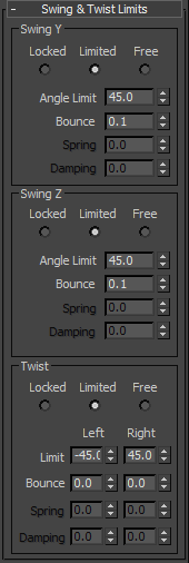

Use these settings to specify the permissible extents of angular movement of the constrained child.
Note: The numeric settings are available only when the Limited option is chosen.
Swing Y and Swing Z groups
Swing Y and Swing Z refer to rotation around the local Y and Z axes, respectively, of the constraint. Choose one of the following for each:
  • Locked Prevents the parent and child objects from rotating around the respective axis of the constraint.
  • Limited Allows the parent and child to rotate a fixed number of degrees, specified by the Angle Limit setting, around the center of the axis.
    To offset the center point, rotate the constraint. The visualization of the constraint helper in the viewports shows the limits.
  • Free Allows the parent and child unrestricted rotation around the local axis of the constraint.
Angle Limit
When Swing is set to Limited, the number of degrees away from the center to allow rotation. This is applied to both sides, so the total range of motion is twice this value. For example, if you set Angle Limit to 45 degrees, the total allowed rotation equals 90 degrees.
Bounce
When Swing is set to Limited, the amount that the objects rebound off the limit when hit. A value of 0.0 indicates no bounce, while a value of 1.0 is full bounce. Available only when Constraint Limits is set to Hard Limits.
Spring
When Swing is set to Limited, the strength of the spring that pulls the objects back to the limit if the limit is exceeded. Small values indicate a low spring force, while larger values will pull the objects with increasing force back to the limit. A value of 0.0 is a special value indicating a hard limit, attempting to prevent the objects from exceeding the swing limit. Available only when Constraint Limits is set to Soft Limits.
Damping
When Swing is set to Limited and the limit is exceeded, the amount of "mud" the objects will rotate through beyond the limit. Available only when Constraint Limits is set to Soft Limits.
Twist group
Twist refers to rotation around the local X axis of the constraint.
  • Locked Prevent the parent and child objects from rotating around the local X axis of the constraint.
  • Limited Allow the parent and child to rotate within a fixed degree range around the local X axis.
  • Free Allow the parent and child to rotate unrestricted around the local X axis of the constraint.
Limit
When Twist is set to Limited, the Left and Right values are absolute degrees for each edge of the limit. (The visualization of these limits in the viewports can help you to adjust them as desired.)
Bounce
When Twist is set to Limited, the amount that the objects rebound off the limits when hit. Each limit may specify a unique value. A value of 0.0 indicates no bounce, while a value of 1.0 is full bounce. Available only when Constraint Limits is set to Hard Limits.
Spring
When Twist is set to Limited, the strength of the spring that pulls the objects back to the limit if either limit is exceeded. Each limit can specify a unique value. Small values indicate a low spring force, while larger values will pull the objects with increasing force back to the limit. A value of 0.0 is a special value indicating a hard limit, attempting to prevent the objects from exceeding the swing limit. Available only when Constraint Limits is set to Soft Limits.
Damping
When Twist is set to Limited and either limit is exceeded, the amount of "mud" the objects will rotate through beyond the limit. Each limit can specify a unique value. Available only when Constraint Limits is set to Soft Limits.

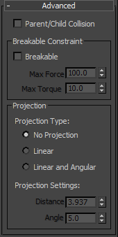

Advanced rollout
Parent/Child Collision
When off (the default), the parent and child rigid bodies connected by a constraint cannot collide with one another. This allows, for example, rigid bodies for a thigh and leg to overlap at the knee without problem. Turn on this option to allow the two rigid bodies to react to each other as well as others.
Breakable Constraint group
Breakable
When on, the constraint can be broken during the simulation. If a linear force exceeding Max Force or a twisting force exceeding the Max Torque (see following) is applied between the parent and child object, the constraint "breaks"; that is, it turns off and is no longer applied.
Max Force
When Breakable is on, the amount of linear force beyond which the constraint will break. To make the constraint more difficult to break, increase the value.
Note: On the Multi-Object Editor panel, this setting is labeled "Break Force."
Max Torque
When Breakable is on, the amount of twisting force beyond which the constraint will break. To make the constraint more difficult to break, increase the value.
Note: On the Multi-Object Editor panel, this setting is labeled "Break Torque."
Projection group
Projection Type
When the parent and child objects violate the limits of the constraint, projection fixes the situation by forcing them to the limits.
Joint projection is something of a "blunt instrument." It simply moves one actor, disregarding any collisions that might otherwise intervene. This can lead to penetration of collision geometries, so it is recommended that you avoid using joint projection unless there are real problems in terms of joint violation, and then use it judiciously.
Choose a projection method and set the corresponding value(s):
  • No Projection Projection is not performed.
  • Linear Projects linear distances only. Set the Distance value.
    This option simulates faster than Linear And Angular.
  • Linear and Angular Performs both linear and angular projection. Set the Distance and Angle values.
    The Linear And Angular option simulates slower but can be more accurate.
Distance
The minimum distance for the constraint violation to exceed for projection to take effect. Errors below this distance will not use projection. Setting this value too low can introduce unwanted oscillations into the simulation.
Angle
The minimum angle (in degrees) that the constraint violation must exceed for projection to take effect. Errors below this angle will not use projection.
