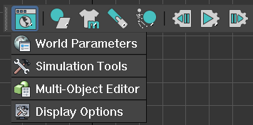

MassFX Tools Flyout
The buttons on this flyout provide direct access to the different panels of the
MassFX Tools dialog. You can also open the dialog with the Show MassFX Tools command on the Simulate menu
Tools - MassFX
Show MassFX Tools.
World Parameters- Opens the MassFX Tools dialog to the World Parameters panel.
Simulation Tools- Opens the MassFX Tools dialog to the Simulation Tools panel.
Multi-Object Editor- Opens the MassFX Tools dialog to the Multi-Object Editor panel.
Display Options- Opens the MassFX Tools dialog to the Display Options panel.

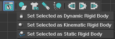

Rigid Body Flyout
Set Selected As Dynamic Rigid Body - Applies a non-instanced
MassFX Rigid Body modifier to each selected object, with Rigid Body Type set to Dynamic, and creates a single convex physical shape for the object. If any selected objects already have a MassFX Rigid Body modifier, the existing modifier is changed to Dynamic, not reapplied.
This command is also available as Set Selected As Dynamic Rigid Body on the Simulate menu
Rigid Bodies
Set Selected As Dynamic Rigid Body.
Set Selected As Kinematic Rigid Body - Apply a non-instanced
MassFX Rigid Body modifier to each selected object, with Rigid Body Type set to Kinematic, and creates single convex physical shape for each object. If any selected objects already have a MassFX Rigid Body modifier, the existing modifier is changed to Kinematic, not reapplied.
This command is also available as Set Selected As Kinematic Rigid Body on the Simulate menu
Rigid Bodies
Set Selected As Kinematic Rigid Body.
Set Selected As Static Rigid Body - Apply a non-instanced
MassFX Rigid Body modifier to each selected object, with Rigid Body Type set to Static. A single convex physical shape is created for the object. If any selected objects already have a MassFX Rigid Body modifier, the existing modifier is changed to Static, not reapplied.
This command is also available as Set Selected As Static Rigid Body on the Simulate menu
Rigid Bodies
Set Selected As Static Rigid Body.

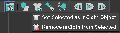

mCloth Flyout
Use these commands to apply the mCloth modifier to an object or to remove the modifier from an object.
Set Selected as mCloth Object- Applies a non-instanced
mCloth modifier to each selected object, then switches to the Modify panel for adjustment of the modifier parameters.
If the object already has the mCloth modifier applied, this command simply switches to the Modify panel if necessary.
Remove mCloth from Selected- Removes the mCloth modifier from each selected object.

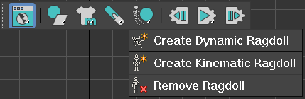

Ragdoll Flyout
Use these controls to allow a bones system or character studio biped to participate in a MassFX simulation, or to remove the character from the simulation. Select any bone in the character or an associated skin mesh and then choose a Ragdoll command, which affects the entire system. See MassFX Ragdoll.
Create Dynamic Ragdoll- Sets up the selected character as a Dynamic ragdoll. Its motion can affect and be affected by other objects in the simulation.
Create Kinematic Ragdoll- Sets up the selected character as a Kinematic ragdoll. Its motion can affect other objects in the simulation but cannot be affected by them.
Remove Ragdoll- Removes the selected character from the simulation by deleting the Rigid Body modifiers, constraints, and Ragdoll helper.

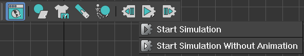

Simulation Controls
Reset Simulation - Halts the simulation, moves the time slider to the first frame, and sets the transforms of any Dynamic rigid bodies to their initial transforms.
This command is also available as Reset Simulation on the Simulate menu
Simulation - MassFX submenu
and on the MassFX Tools dialog
Start Simulation - Runs the simulation from the current
simulation frame. By default, this is the first frame in the animation, which is not necessarily the same as the current animation frame. If the simulation is already running, causing the button to appear pressed in, clicking the button pauses the simulation at the current simulation frame.
If the simulation is paused, click Start Simulation again to resume the simulation from the current simulation frame.
As the simulation runs, the time slider advances by one frame for each simulation step, causing Kinematic rigid bodies to move as part of the simulation.
This command is also available as Play Simulation on the Simulate menu
Simulation - MassFX submenu (when Start Simulation is active on the MassFX toolbar) and as
(Start Simulation) on the MassFX Tools dialog
Start Simulation Without Animation (on Start Simulation flyout) - Similar to Start Simulation, described preceding, except that the time slider does not advance as the simulation runs. This can be useful for letting Dynamic rigid bodies move to a resting spot in preparation for using
Capture Initial Transforms.
Simulation - MassFX submenu (when Start Simulation Without Animation is active on the MassFX toolbar) and as
(Start Simulation Without Animation) on the MassFX Tools dialog
Advance the simulation by one frame - Runs the simulation for a single frame while advancing the time slider by the same amount.
This command is also available as Step Simulation on the Simulate menu
Simulation - MassFX submenu and as
(Advance the simulation by one frame) on the MassFX Toolbar.
