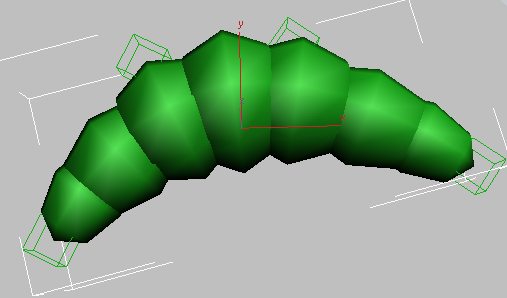

The following illustration shows a muscle strand intended for use a bicep.
Freshly created muscle strand, suitable for shaping into a bicep

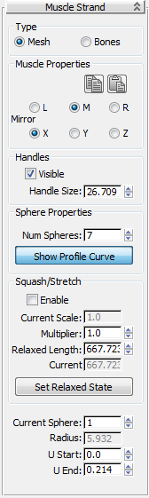

Interface
Type group
Choose Mesh or Bones. Both types have in common the ability to move the handles to reshape the muscle strand, with each handle having its own name while remaining a part of the strand. The differences are as follows:
- Mesh The muscle strand acts as a single piece. This mode is best when used in conjunction with the Skin Wrap modifier (see Usage).
- Bones Each sphere acts as a separate bone and has its own name. As a result, you can attach a subset of the spheres to the Skin modifer when you don’t need all of them. Note: You can select individual spheres of a bones-type Muscle Strand object, but moving any sphere moves the entire muscle.
Muscle Properties group
This also applies to a Muscle Strand object with Type set to Bones, when you rename the first sphere (default name: MuscleStrand01). However, renaming the first sphere does not affect the names of the other spheres, nor does renaming any other sphere in the muscle strand affect the object’s other components.
Copy Strand Settings - Copies the settings for the selected muscle strand to a memory buffer, ready for pasting to another strand.
Paste Strand Settings - Pastes settings copied from another muscle strand to the selected strand.
- L/M/R
- Left/Middle/Right: The side of the rig the muscle strand is on. For example, you can set up a strand on the left side, choosing the L option, and then mirror the strand across the center axis and specifying the R option.
- Mirror: X/Y/Z
- The axis along which the muscle strand lies. This helps the mirroring system work.

Sphere Properties group
- Num Spheres
- The number of spheres that make up the Muscle Strand. The higher this value, the greater the resolution of the muscle.

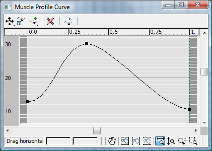

- Show Profile Curve
- Opens the Muscle Profile Curve dialog containing a graph that you can edit to control the profile, or outline, of the Muscle Strand. By default, the muscle is thick in the middle and thin at the ends, but you can change this by moving the three points on the curve (it’s not possible to add points to the curve).
To finish editing the curve, close the dialog or click Show Profile Curve again.

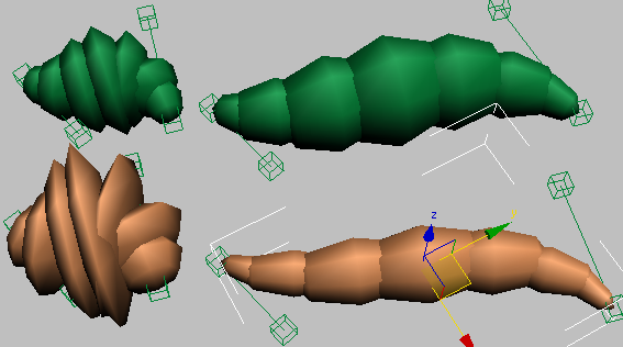

Squash/Stretch group
- Enable
When on, changing the muscle length affects the profile: Shortening the muscle makes it thicker (squash) while lengthening it makes it thinner (stretch). When off, the profile is not affected by the length.
Top: With Squash/Stretch off, Muscle Strand profile stays the same whether the muscle is shorter (left) or longer (right).
Bottom: With Squash/Stretch enabled, Muscle Strand becomes thicker when short (left) and thinner when long (right).
- Current Scale
- This read-only field shows the scaling amount of the muscle based on the relaxed state (see following) and the length as adjusted by moving the endpoints.
When Current Scale is 1.0, the muscle is in its relaxed state. When Current Scale is greater than 1.0, the muscle is squashed, and when less than 1.0, the muscle is stretched.
- Multiplier
- Increases or decreases the amount of squash and stretch. Increase this value for an exaggerated effect.
- Relaxed Length
- The length of the muscle when relaxed; that is, when Current Scale = 1.0.
- Current
- This read-only field shows the current length of the muscle.
- Set Relaxed State
- Click to set the relaxed state. This sets Relaxed Length to the current length, and Current Scale to 1.0.
Thereafter, making the muscle shorter than the Relaxed Length causes squashing, and making it longer causes stretching.
[sphere settings group]
The remaining controls on the Muscle Strand rollout let you set the length of each sphere in the muscle by adjusting its extent. Set Current Sphere to the sphere to adjust and then change the U Start and U End values.
- Current Sphere
- The sphere to adjust. This can be any value from 1 to [Num Spheres].
- Radius
- This read-only field shows the radius of the current sphere.
- U Start / U End
- The extents of the current sphere, measured in relation to the full length of the sphere, which in this context extends from 0.0 to 1.0. Essentially, you’re setting the percents along the muscle length at which the sphere starts and ends.
To make the sphere shorter, increase U Start or decrease U End, and to make the sphere longer, decrease U Start or increase U End.
For example, to make a sphere start 25 percent along the muscle length and end at 28 percent, set U Start to 0.25 and set U End to 0.28.
