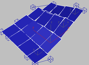

- Bones Each panel acts as a separate bone and has its own name, and the panels can separate somewhat when the muscle is reshaped by moving the handles. As a result, you can attach a subset of the panels to the Skin modifer when you don’t need all of them.

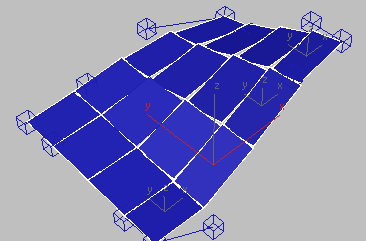

CATMuscle set to Bones (Remove Skew off)

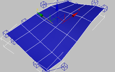

- Remove Skew
- When Type is set to Bones, the panel corners can form angles other than 90 degrees when the muscle is deformed by moving the handles. To force the panel corners to always assume right angles, turn on Remove Skew. Available only when Type is set to Bones.
This option is intended primarily for exporting to a game engine that does not support skewed bones.
CATMuscle set to Bones (Remove Skew on)

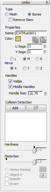

Properties group
- Name
- The base name for the muscle components. CAT uses this name as a basis for the various components.
For example, if you name a mesh CATMuscle Lats, the muscle itself is named LatsM and the corner handles are named LatsM_A, LatsM_B, and so on; the subsidiary handles (attached to the corner handles) are named LatsM_AB and so on.
Each panel in the bones-type CATMuscle has its own name, created by appending the base name with M and a number derived from the panel’s row and column, with the counts starting at 0. For example, in a 20 x 20 (U Segs x V Segs) muscle, the tenth panel in the first row would be LatsM09, and the twelfth panel in row 15 would be LatsM1411. The naming of the handles is the same as for mesh muscles (see preceding).
- Color
- The color of the muscle and its handles. To change the color, click the color swatch.
Copy Muscle Settings - Copies the settings for the selected CATMuscle to a memory buffer, ready for pasting.
Paste Muscle Settings - Pastes settings copied from another CATMuscle to the selected muscle.
- U Segs / V Segs
- The number of segments into which the muscle is subdivided in the horizontal and vertical dimensions, respectively. The greater these numbers, the more definition available for deforming the muscle.
- L/M/R
- Left/Middle/Right: The side of the rig the muscle is on. For example, you can set up a muscle on the left side, choosing the L option, and then mirror the muscle across the center axis and specifying the R option.
- Mirror: X/Y/Z
- The axis along which the muscle lies. This helps the mirroring system work.
Handles group
Each CATMuscle has a handle at each corner, and each of those handles has two subsidiary handles that act like handles of Bezier-curve knots. You can alter the muscle shape by moving these handles, and you can also link any handle as the child of another object, such as a bone in a character rig. Thereafter, moving the parent object (the bone) also moves the handle, causing the muscle to deform accordingly.
- Visible
- Toggles display of the muscle handles.
Normally, handles are depicted in the viewports as wireframe cubes surrounding the muscle; to disable the display of the handles, turn off Visible.
This can be useful for simplifying the viewport display after connecting the muscles to their bones, and selecting the handles is no longer necessary.

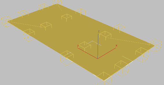

- Middle Handles
- Toggles display of an additional Bezier-type handle connected to each corner handle, positioned near the center of the muscle. Use the handles to further modify the muscle shape.
- Handle Size
- The size of each handle; changing this affects all handles. Normally, the handles are sized proportionally to the overall muscle size when you create it; use this setting to make the handles larger or smaller.
Collision Detection group

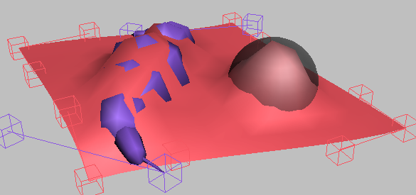

In addition to being able to shape the CATMuscle by moving its handles, you can specify collision objects around which the muscle deforms when in proximity to them. For example, if you use a sphere as a collision object and move it around while intersecting the CATMuscle, the part of the muscle nearest the sphere forms a raised section. The deformation is greatest at the center of the collision object, and falls off toward its exterior. You can specify collision attributes for each collision object separately.
CATMuscle reshaped by Muscle Strand and sphere. The sphere is set to See-Through display so the full deformation is visible.
- Pick Collision Object
- Add a collision object to the list by clicking this button and then selecting the object.
- Remove Highlighted Collision Object
- After highlighting a list entry, click this button to remove it from the list.
- [list]
- Lists all collision objects for the current muscle. To remove an object from the list or change its properties, highlight it in the list and then use the appropriate controls.
- Hardness
- The extent to which the highlighted list item deforms the muscle. Default=1.0.
- Distortion
- Adds a roughness to the deformation caused by the collision object. In general, keep this value below 0.5.
- Vertex Normal / Object X
- Choose the direction of deformation caused by the collision object. Available only when a collision object is highlighted in the list.
- Vertex Normal This, the default choice, causes deformation in the direction of the surface normal of the affected area of the muscle; that is, perpendicular to the surface.
- Object X Causes deformation in the positive direction of the collision object’s local X axis. To change the deformation direction, rotate the collision object.
This setting makes it possible to have a tubular piece of skin, like an arm, with collision objects inside, and have CATMuscles colliding with them. At the edge where two CATMuscles meet, you usually want to avoid tearing due to the points at the joining edges on the muscles moving in different directions because of distortion. If you choose Object X, the points along the edges of the two muscles will move in the same direction because both are being deformed by the same object.
- Smooth
- When on, evens out the deformation caused by a collision object. Available only when a collision object is highlighted in the list.
- Invert
- Reverses the direction of deformation caused by a collision object. Available only when a collision object is highlighted in the list.
