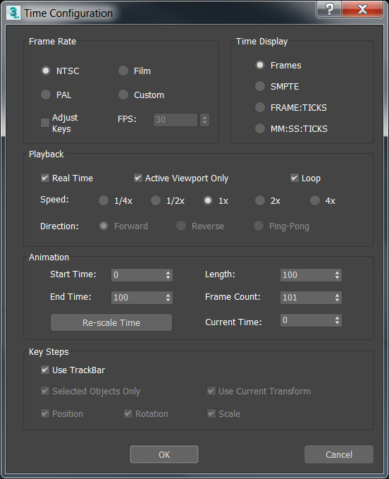

Choosing the Time Display Format
When you start 3ds Max, the default time display is in frames, but you can use alternative time-display formats. For example, you might want to see time in seconds and minutes.
You can specify different time-display formats using the Time Configuration dialog
Time Display group settings. When you change the time display format, you not only change the way that time is shown in all parts of 3ds Max, but you also change the method with which you access time.
You can use these time display formats:
- Frames
Displays time in whole frames.
This is the default display mode. The amount of time covered by a single frame depends on your choice for the current frame rate. For example, in NTSC video each frame represents 1/30th of a second.
- SMPTE
Displays time using the Society of Motion Picture and Television Engineers format.
This is the standard time-display format for most professional animation work. From left to right, the SMPTE format displays minutes, seconds, and frames, delineated by colons. For example, 2:16:14 represents 2 minutes, 16 seconds, and 14 frames.
- FRAME:TICKS
Displays time using frames and the 3ds Max internal time increment, called "ticks."
There are 4,800 ticks per second, so you can actually access time intervals as small as 1/4800 of a second.
- MM:SS:TICKS
Displays time in minutes (MM), seconds (SS), and ticks, delineated by colons. For example, 2:16:2240 represents 2 minutes, 16 seconds, and 2,240 ticks.
