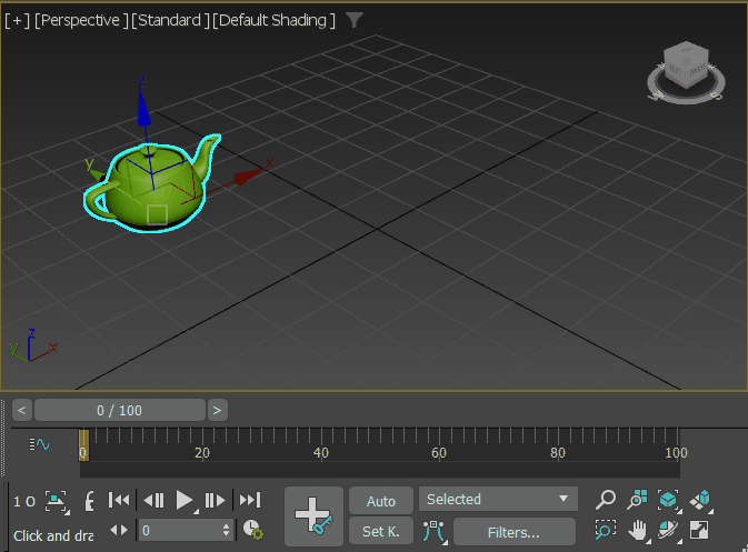

Turning on Auto Key has the following effects:
- The Auto Key button, the time slider, and the border of the active viewport turn red to indicate you are in animation mode.
- When you transform an object or change an animatable parameter, 3ds Max creates keys at the current frame, as indicated by the time slider position.
To begin animating an object:
- Click Auto to turn on Auto Key mode.
- Drag the time slider to a different time.
- Do one of the following:
- Transform an object.
- Change an animatable parameter.
For example, if you have a cylinder that has not been animated yet, it has no keys. If you turn on Auto Key, and at frame 20 you rotate the cylinder 90 degrees about its Y axis, rotation keys are created at frames 0 and 20. The key at frame 0 stores the original orientation of the cylinder, while the key at frame 20 stores the animated orientation of 90 degrees. When you play the animation, the cylinder rotates 90 degrees about its Y axis over 21 frames.
