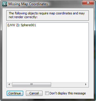

The Missing Map Coordinates dialog is displayed when you attempt to render one or more objects with materials whose maps use a map channel other than channel 1. (Channel 1 is an exception because channel 1 mapping coordinates are automatically turned on when you assign a mapped material to an object.) Only maps with Show Map In Viewport toggled on are listed as missing.

The list shows the map channel followed by the name of the object.
Continue
Proceeds with the rendering. The objects listed will not show maps in the material assigned to them, and might not be visible at all.
Cancel
Cancels rendering.
