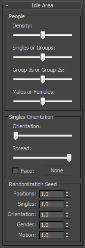

Idle Area Rollout (Populate)
Has controls for the behavior of idle areas.
  • Create or select a Populate idle area. > Modify panel > Idle Area rollout
In Populate, an idle area is a surface on which simulated people "hang out" by themselves or interact with others. Visible features include circles that show groups of people talking, and markers that show each character's position, starting orientation, and gender: red for female and blue for male.
