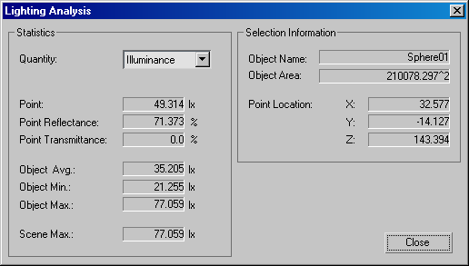

To query light levels, analyze the data, and produce reports, use the Lighting Analysis dialog. This dialog provides rendering data on material reflectance, transmittance, and luminance.
For example, a lighting engineer might need to know if light fixtures in a scene provide an even level of illumination on the walls of a building. The engineer uses the Lighting Analysis dialog after placing the lights in the ceiling and processing radiosity. The engineer inspects the light levels and material reflectance in the scene and then adjusts the brightness of lights, changes units, or reduces material reflectance.

Interface
Statistics group
Displays the radiosity solution lighting statistics for the object you select.
- Quantity
- Choose the desired photometric value:
- Luminance The amount of energy leaving a surface.
- Illuminance The amount of energy arriving at a surface.
- Point
- The luminance or illuminance at the point on the object where you clicked.
- Point Reflectance
- The reflectance of the surface material at the point on the object where you clicked.
- Point Transmittance
- The transmittance of the surface material at the point on the object where you clicked.
- Object Avg
- The amount of light intensity for the object as a whole.
- Object Min
- The object’s minimum luminance or illuminance value.
- Object Max
- The object’s maximum luminance or illuminance value.
- Scene Max
- The scene’s highest luminance or illuminance value.
Selection Information group
- Object Name
- The name of the selected object.
- Object Area
- The area size of the selected object.
- Point Location
- The X,Y,Z coordinate of the point on an object you clicked.
