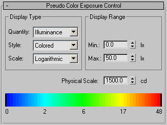

Display Type group
- Quantity
- Chooses the value being measured.
- Illuminance (the default) displays values of light incident on surfaces.
- Luminance displays values of light reflected off surfaces.
- Style
- Chooses the way to display values.
- Colored (the default) shows a spectrum.
- Grayscale shows gray tones that range from white to black.
The spectrum bar displays the values the rendering will use.

Display Range group
- Min. [Minimum]
- Sets the lowest value to measure and represent in the rendering. Values at this quantity or below it all map to the leftmost display color (or grayscale level).
- Max. [Maximum]
- Sets the highest value to measure and represent in the rendering. Values at this quantity or above it all map to the rightmost display color (or grayscale value).
Physical Scale display
- Physical Scale
- Sets a physical scale for exposure control to use with lights that are not physically based. The result is an adjustment of the rendering that approximates the eye's response to the scene.
Changing the value of Physical Scale is an optional step. Use it as a last resort when the materials or maps are not rendering correctly. Changing this setting will not affect anything in the scene unless your scene has an Ambient Color different than black. If you do adjust it, set the Physical Scale value to the equivalent of the brightest light source in the scene.
3ds Max multiplies each standard light's Multiplier by the Physical Scale value to produce a light intensity value in candelas. For example, with the default Physical Scale of 1500, a standard omni light is treated by the renderer and radiosity as a photometric isotropic light of 1500 candelas. Physical Scale is also factored into reflections, refractions, and self-illumination.

- [spectrum bar]
- Shows the spectrum-to-intensity mapping. The numbers below the spectrum range from the Minimum to the Maximum settings.
When rendering with pseudo color, the spectrum bar is displayed beneath the pseudo color image, labeled either Luminance or Illuminance.
