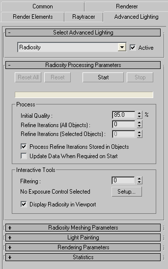

Radiosity to display the Advanced Lighting panel with Radiosity chosen as the advanced lighting type.
The rollouts for radiosity are displayed.
- Choose Rendering
Radiosity to display the Radiosity panel.
- On the Radiosity Processing Parameters rollout, click Start to begin processing radiosity.
- To render the scene after radiosity processing completes, click Render.

Advanced Lighting to display the Advanced Lighting panel. On the Select Advanced Lighting rollout, choose Radiosity as the advanced lighting type.
- Choose Rendering
Advanced Lighting
- On the Radiosity Processing rollout, under Interactive Tools, click Setup to display the
Environment panel where you set exposure controls.
