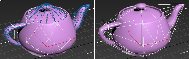

- Generate Shape Per Element
- When on and you apply the MassFX Rigid Body modifier to an object, MassFX creates a separate physical shape for each element in the object. When off, MassFX creates a single physical shape for the entire object. The latter option tends to be less accurate, but can simulate faster.
For example, the Teapot primitive in 3ds Max consists of four elements: Body, Handle, Spout, and Lid. The following illustration compares the generated physical shapes for the teapot with Generate Shape Per Element on and off. The version on the left, with four physical shapes, still has some "blocked-off" concave areas, such as the inside of the handle, but it's closer to the actual shape of the teapot.
Left: Generate Shape Per Element=on
Right: Generate Shape Per Element=off
Note: This switch applies only to subsequently created rigid bodies. You cannot switch an existing Rigid Body modifier between single-shape and shape-per-element mode.
