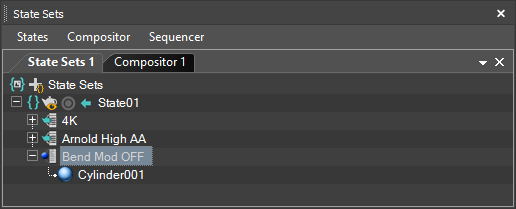

Recording workflow
In general, it's best to use either a node based approach or a recording approach. However, you can add recorded options to the node based approach, and vice versa. This is useful as not all tracked actions are available as nodes.
For instance, if you wish to turn off a modifier on an object for which you want to record the action. The recorded action may not appear in the node view, but it is still visible in the tree view.
