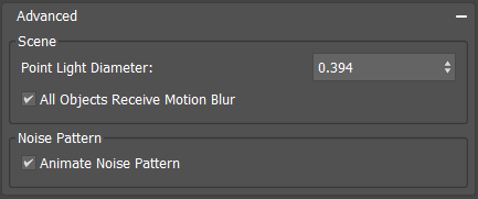

Scene group
Point Light Diameter
Renders all point lights as spherical or disk lights of the set diameter. Similarly, linear lights are rendered a cylindrical or rectangular lights with the set value as the diameter/width.
All Object Receive Motion Blur
Enables motion blur on all objects in the scene, regardless of whether they have it enabled in the object properties.
Noise Pattern group
Animate Noise Pattern
Varies the noise pattern for each frame of an animated render. This is desirable for high quality animation renders as it produces a more natural look, akin to film grain.
Note: Animate noise pattern for high quality animation renders with a more natural look, akin to film grain. For low quality (draft) renders a static noise pattern may suffice.
