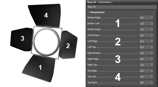

The Barndoor light filter introduces four barn door flaps. Each barn door flap has three parameters. The first two parameters position the two ends of the flap across the face of the light. The third parameter (edge) controls the softness of the edge. This light filter can only be used with spot lights.
Barndoor light filter parameters

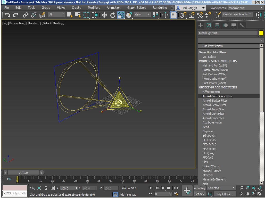

  • Create a spot_light and a polygon plane. Point the spot_light at the plane. Increase the cone_angle so that you can see the effect of the light.
  • In the Modify Panel for the spot_light, select Arnold Barn Door Filters from the scroll down menu. This will automatically make a connection between the spot_light and the barndoor filter.
Create barndoor in Arnold attributes of spot_light
