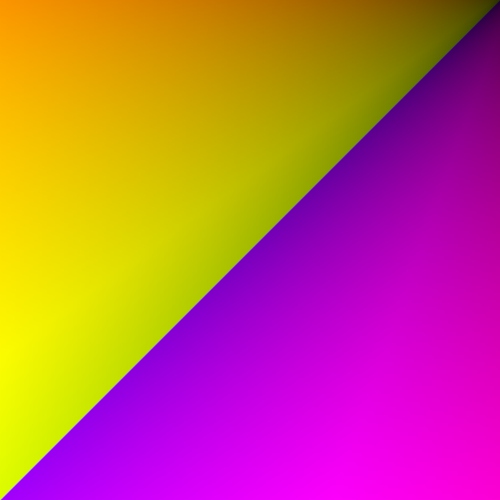

  • Connect a color_jitter shader to the emission_color of the standard_surface shader and increase the emission_weight to 1.
  • Connect a utility shader to the input of the color_jitter shader. Change the shade_mode to flat in the utility shader. This is because we only want pure color from the Utility shader to create a pattern. Change the overlay_mode to polywire. This will overlay a wireframe on top of the color.
  • In this case, the color_mode has been set to uv_coords. This will give us a diagonal wipe effect to our pattern, once it is animated. You can, of course, choose a different color_mode like U or V coords or something entirely different. The idea is to experiment and have fun finding different techniques!

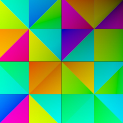

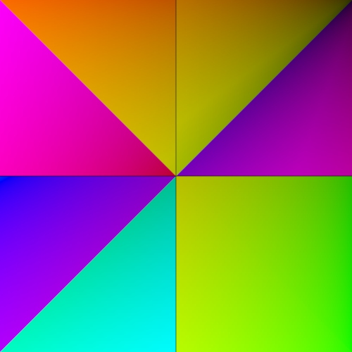

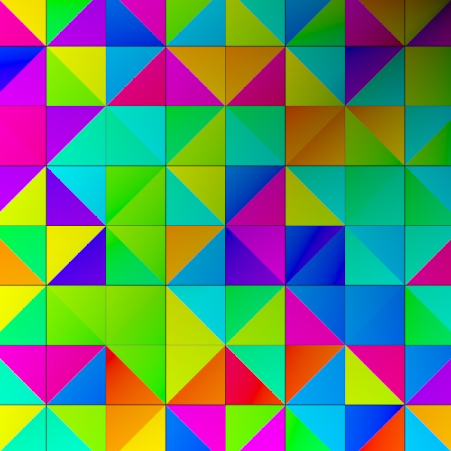

  • Increase the hue_max (Face) of the color_jitter shader to see the effect that it has on the utility shader. If the plane does not have enough subdivisions, you can always increase the number of subdivision_iterations for the plane.
0 1 2 3
More triangles are visible when increasing the number of subdivision_iterations
