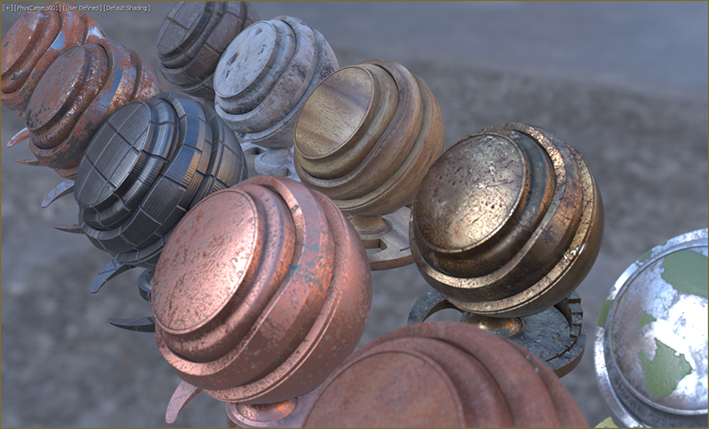

The PBR (specular/gloss) material is a physically based rendering material provides an accurate representation of how light interacts with surfaces.
