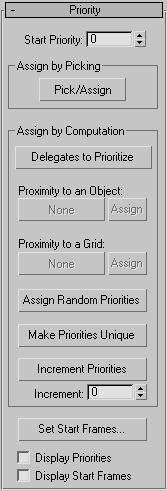

The Crowd system uses the Priority rollout settings when solving a simulation involving bipeds associated with delegates.
  • Create panel > (Helpers) > Object Type rollout > Crowd > Priority rollout
  • Select a Crowd object. > Modify panel > Priority rollout

Interface
Start Priority
Sets the initial priority value. Applies to the first four methods of setting priorities: Assign By Picking, Proximity To An Object, Proximity To A Grid, and Assign Random Priorities. Default=0.
Note: Priority is assigned in increasing order. Thus, a delegate with Priority value 0 goes before a delegate with Priority 1, 1 goes before 2, and so on.
Assign by Picking group
Pick/Assign
Lets you assign successively higher Priority values to any number of delegates by selecting each in turn in the viewport. The first delegate you select is assigned the Start Priority value. The Priority value assigned to each succeeding delegate you select is incremented by one.
To stop assigning priorities, right-click in a viewport or click the Pick/Assign button again.
Delegate priorities appear in viewports as black numerals attached to each delegate; they're usually most easily seen in Wireframe views.
Note: You can undo and/or redo assignments during the process.
Tip: It's possible to assign two or more delegates the same priority value using this method. In such a case, for more predictable behavior, use Make Priorities Unique so that delegates don't share priorities.
Assign by Computation group
This group provides five different methods for assigning priorities to delegates, plus a button for selecting delegates to be affected by these methods.
Delegates to Prioritize
Lets you use the Select dialog to specify delegates to be affected by subsequent use of other controls within this group. Select the delegates with the Select dialog, and then click Select to exit the dialog. This selection applies only to Proximity assignments (that is, Proximity To An Object and Proximity To A Grid).
Proximity to an Object
Lets you assign priorities based on delegates' distance from a specific object. To specify the object, click the None button, and then select the object on which priorities are to be based. Lastly, click the Assign button to compute and assign priorities. The delegate closest to the object is assigned the Start Priority value, and each successively farther delegate is assigned the next highest priority.
For any delegates that are equidistant from the object, character studio assigns priorities randomly.
Proximity to a Grid
Lets you assign priorities based on delegates' distance from an infinite plane defined by a specific grid object. To specify the grid object, click the None button, and then select the grid object on which priorities are to be based. Lastly, click the Assign button to compute and assign priorities. The delegate closest to the grid object is assigned the Start Priority value, and each successively farther delegate is assigned the next highest priority.
For any delegates that are equidistant from the plane, character studio assigns priorities randomly.
Assigns random priorities to the selected delegates. The range of priority values assigned lies between the Start Priority value and that value plus the number of selected delegates.
Ensures that all delegates have unique priority values. If two delegates share the same priority, one of them will be given a new priority value that differs from the rest.
Increment Priorities
Increments the priorities of all selected delegates by the Increment value.
Increment
Sets the value by which the Increment Priorities button adjusts delegate priorities. Use a negative Increment value to decrement priorities. Default=0.
Set Start Frames
Opens the Set Start Frames dialog, for setting start frames based on assigned priorities.
Display Priorities
Enables the display of assigned priority values as black numerals attached to the delegates. Default=off.
Display Start Frames
Enables the display of assigned start frame values as black numerals attached to the delegates. Default=off.
When both Display Priorities and Display Start Frames are on, the two values are displayed side by side, separated by a slash symbol (/). The priority appears to the left of the slash and the start frame appears to the right.
