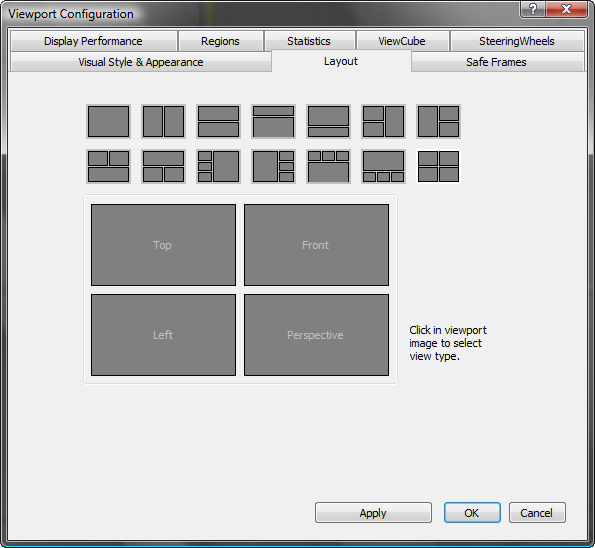

3ds Max defaults to a 2 x 2 arrangement of viewports. Thirteen other layouts are available, but the maximum number of viewports on the screen remains four.
Using the Layout Panel of the Viewport Configuration dialog, you can pick from the different layouts and customize the viewports in each. The viewport configuration is saved with your work.
Tip: With the Viewport Layouts feature, you can set up any number of custom layouts and switch among them with a click of the mouse.
