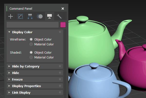

The Display Color rollout specifies whether 3ds Max displays objects using their wireframe colors (also known as object colors) or their diffuse material colors, when the objects have their display properties set to By Object.
If the display properties of an object is set to By Layer, the layer color is used for viewport display. You can choose one method for wireframe display and a different one for shaded display. In each shading mode you can specify whether the material or the object color is used.

Interface
- Wireframe
Changing the color of the wireframe to match the object color
Controls the color of objects when the viewport is in wireframe display mode.
- Object Color Displays the wireframes in object color.
- Material Color Displays the wireframes using the material color.
Tip: To customize the color of the selection wireframe from the (default) white, go to and choose the Colors tab. Select Geometry from the Elements drop-down, and then scroll to Selection. Double click the white color tile to the right of the Elements drop-down to open the color picker for you to select a new color. Click Save.This change takes effect only after you close and restart 3ds Max.
- Shaded
Controls the color of the object when the viewport is in any shaded display mode.
- Object Color Displays the shaded objects using the object color.
- Material Color Displays the shaded objects using the material color.
