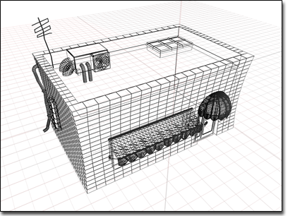

- Axonometric views show the scene without perspective. All lines in the model are parallel to one another. The Top, Front, Left, and Orthographic viewports are axonometric views.
Axonometric view of a scene

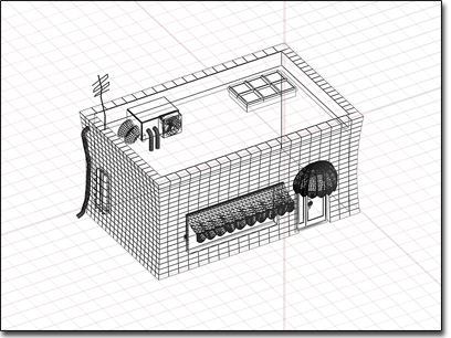

- Perspective views show the scene with lines that converge at the horizon. The Perspective and Camera viewports are examples of perspective views.
Perspective view of the same model

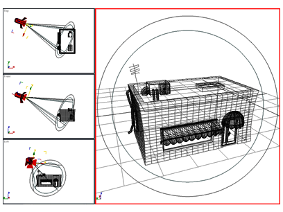

Light view works much like a targeted camera view. You first create a spotlight or directional light and then set the active viewport to that spotlight. The easiest way is to press the keyboard shortcut $. See Lights.
The viewport on the right looks through the lens of a spotlight in the scene.
