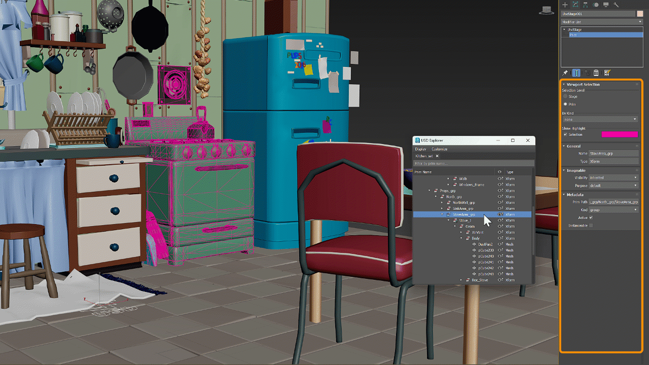

Edit prim properties.
The Modify panel now displays prim properties, letting you inspect USD prims, view their data, and make edits as needed.
