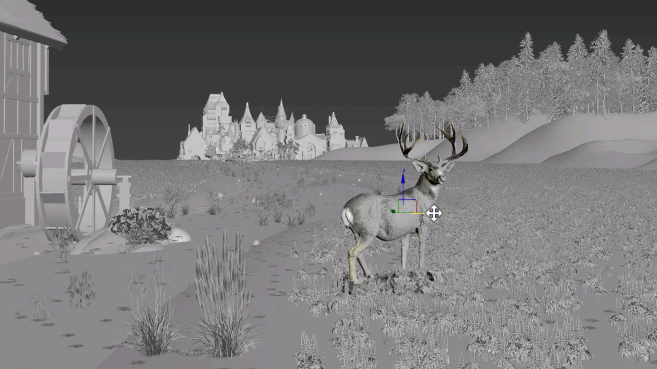

Duplicate to USD. You can now send objects from the 3ds Max scene into a USD stage using Duplicate as USD data. Combined with the previously released Promote to 3ds Max, this helps streamline the workflow between 3ds Max and USD.
gif for camera
