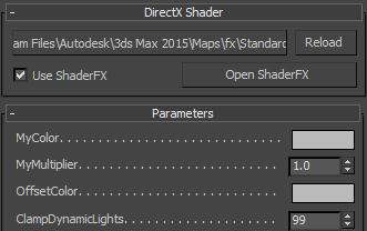

- Select the newly created Color node. On the Properties panel, enter the name OffsetColor and change the UI Order value to 3.
OffsetColor now appears on the Material Editor
Parameters rollout.
OffsetColor attribute on the Parameters rollout

- Give your group node ports unique names. Currently, all ports are named Value, and thus the shader is invalid. (If you look at the Material Editor, the Parameters rollout displays an error message.)

Compute Graph. Now the shader is valid again.
In the Material Editor, the Parameters rollout for this shader reappears.
