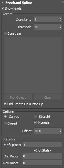

Freehand Spline rollout, Create mode
Rollout shown before spline is drawn.
Show Knots
Displays knots on the spline.
Create group
Granularity
The number of cursor position samples taken before a knot is created.
Threshold
Sets how far the cursor must move before a new knot is created. A higher value increases the distance.
Constrain
Constrains the spline to selected objects in the scene.
Pick Object button
Enables Object Selection mode for constraining objects. When you have finished picking objects, click again to complete the operation.
Clear
Clears the list of selected objects.
End Create On Button Up
When enabled, creates a Freehand spline when the mouse button is released. When disabled, the shape is continued when the mouse button is pressed again, automatically connecting the open end of the spline; you must press Esc or right-click in the viewport to finish drawing.
Options group
Curved/Straight toggle
Sets whether the segments between knots are curved or straight.
Closed
Draws a line between the beginning and the end of the spline to close it.
Normals
Shows the resulting normals of the constrained spline in the viewport.
Offset
Offsets the position of the hand-drawn spline away from the surface of the constraining object.
Statistics group
Number of Splines
Displays the number of splines in the shape.
Original Knots
Shows the number of knots automatically created while drawing the spline (0 before drawing).
New Knots
Shows the new number of knots (0 before drawing).
Freehand Spline rollout, Modify mode
Rollout shown once the spline has been created.
Show Knots
Options group
Sampling
Sets the sampling amount. Values greater than zero progressively reduce neighboring knots, smoothing the result.
Closed
Normals
Offset
Statistics group
Number of Splines
Orig Knots
Shows the number of knots automatically created while drawing the spline.
New Knots
