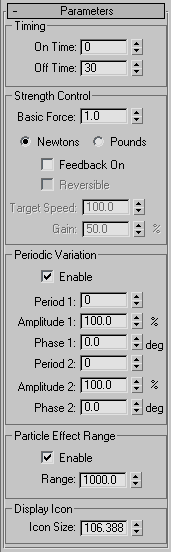

Timing group
On Time/Off Time
The numbers of the frames in which the space warp begins and ends its effect. Because Push moves the particles to which it's applied over time, no keyframes are created.
Strength Control group
Basic Force
The amount of force exerted by the space warp.
Newtons/Pounds
This option specifies the units of force used by the Basic Force spinner.
A pound is about 4.5 Newtons, and one newton is one kilogram-per-second-squared. When Push is applied to particle systems, these values have only subjective meaning because they depend on the built-in weighting factors and time scaling used by the particle system.
Feedback On
When on, the force varies depending on the speed of the affected particles relative to the specified Target Speed. When off, the force remains constant, regardless of the speed of the affected particles.
Reversible
When on, if the particle's speed exceeds the Target Speed setting, the force is reversed. Available only if you turn on Feedback On.
Target Speed
Specifies the maximum speed in units per frame before the Feedback takes effect. Available only if you turn on Feedback On.
Gain
Specifies how quickly the force adjusts to approaching the target speed. If set to 100 percent, the correction is immediate. If set lower, a slower and "looser" response occurs. Available only if you turn on Feedback On.
Note: Setting Gain above 100 percent can result in over-correction, but is sometimes necessary to overcome damping from other system settings, such as IK damping.
Periodic Variation group
These settings introduce variations into the force by affecting the Basic Force value randomly. You can set two waveforms to produce a noise effect.
Enable
Turns on the variations.
Period 1
The time over which the noise variation makes a full cycle. For example, a setting of 20 means one cycle per 20 frames.
Amplitude 1
The strength of the variation (in percent). This option uses the same types of units as the Basic Force spinner.
Phase 1
Offsets the variation pattern.
Period 2
Provides an additional variation pattern (a second wave) to increase the noise.
Amplitude 2
The strength of the variation of the second wave (in percent). This option uses the same types of units as the Basic Force spinner.
Phase 2
Offsets the variation pattern of the second wave.
Particle Effect Range group
Lets you restrict the Push effect's range to a specific volume.
Enable
When on, limits the range of the effect to a sphere, displayed as a tri-hooped sphere. The effect falls off increasingly as the particles near the boundary of the sphere.
Range
Specifies the radius of the range of the effect, in units.
Display Icon group
Icon Size
Sets the size of the Push icon. This is for display purposes only, and does not alter the Push effect.
