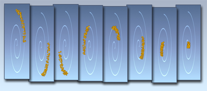

The Path Follow space warp forces particles to follow a spline path.
  • Create panel > (Space Warps) > Forces > Object Type rollout > Path Follow button
  • Default menu: Create menu > SpaceWarps > Forces > Path Follow
  • Alt menu: Objects menu > Forces > Path Follow
Particles following a spiral path
Note: Path Follow is the only Force space warp that does not support Particle Flow. To make Particle Flow particles follow a path, use the Speed By Icon operator and use Path Constraint to assign its icon to the path. For an example, see this procedure.

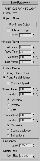

Interface
Current Path group
Lets you choose the path for the particles, and specify the range of influence of the Space Warp.
Object
Displays the name of the currently assigned path.
Pick Shape Object
Click this, and then click a shape in the scene to select it as a path. You can use any shape object as a path; if you select a multiple-spline shape, only one the lowest-number spline is used. You can also use NURBS curves as paths.
Unlimited Range
When off, the range of influence of the space warp is limited to the value set in the Distance spinner. When on, the space warp influences all bound particles in the scene, regardless of their distance from the path object.
Range
Specifies the range of influence when Unlimited Range is off. This is the distance between the path object and the particle system. The position of the Path Follow space warp's icon is ignored.
Motion Timing group
These controls affect how long particles are influenced by Path Follow.
Start Frame
The frame at which Path Follow begins to influence the particles.
Travel Time
The time each particle takes to traverse the path.
Variation
The amount by which each particle's travel time can vary.
Last Frame
The frame at which Path Follow releases the particles and no longer influences them.
Particle Motion group
The controls in this area determine the motion of particles.
  • Along Offset Splines The distance between the particle system and the path alter the effect of the particle motion. If the first vertex of the spline is at the birthplace of the particle, the particle follows the spline path. If you move the path away from the particle system, the particles are affected by the offset.
  • Along Parallel Splines Particles follow a copy of the selected path, parallel to the particle system. In this mode, the position of the path relative to the particle system does not matter. The orientation of the path, however, affects the particle stream.
Constant Speed
When on, all particles travel at the same speed.
Stream Taper
Causes particles to converge or diverge toward the path over time, or to simultaneously converge and diverge. You specify the effect by choosing Converge, Diverge, or Both (see following). This provides a tapering effect over the length of the path.
Variation
The amount by which Stream Taper can vary for each particle.
  • Converge When Stream Taper is greater than 0, the particles move in toward the path as they follow the path. The effect is that the stream tapers from larger to smaller over time.
  • Diverge Provides the opposite effect of Converge. The particles diverge from the path over time.
  • Both Splits the particle stream, causing some particles to converge and others to diverge.
Stream Swirl
Specifies the number of turns by which particles spiral about the path. In conjunction with Stream Taper, alters the diameter of the spiral.
Stream Swirl is generally more effective when you choose Along Offset Splines.
Variation
The amount by which each particle can vary from the Spiral value.
  • Clockwise Particles spiral in a clockwise direction.
  • Counterclockwise Particles spiral in a counterclockwise direction.
  • Bidirectional The stream is split so that particles spiral in both directions.
Uniqueness group
Provides a seed number for unique generation of the particle pattern.
Seed
Specifies the seed number for the current Path Follow.
Display Icon group
Affects the display of the Path Follow icon.
Icon Size
Specifies the size of the Path Follow icon. Does not alter the Path Follow effect.
Was this information helpful?
