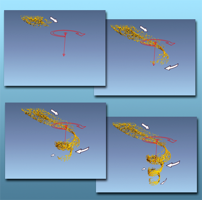

The Vortex space warp applies a force to particle systems, spinning them through a whirling vortex, and then moving them down a long, thin spout or vortex well. Vortex is useful for creating black holes, whirlpools, tornadoes, and other funnel-like objects.
The space warp settings let you control the vortex shape, the well characteristics, and rate and range of particle capture. The shape of the vortex is also affected by particle system settings, such as speed.
Particle stream caught in a vortex

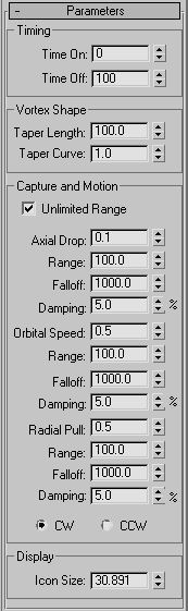

Interface
Timing group
- Time On/Time Off
- The frame numbers at which the space warp becomes active and becomes inactive.
Vortex Shape group
- Taper Length
- Controls the length of the vortex, as well as its shape. Lower settings give you a "tighter" vortex, while higher settings give you a "looser" vortex. Default=100.0.
- Taper Curve
- Controls the shape of the vortex. Low values create a vortex with a wide, flared mouth, while high values create a vortex with nearly vertical sides. Default=1.0. Range=1.0 to 4.0.
Capture and Motion group
This group contains basic settings for Axial Drop, Orbital Speed, and Radial Pull, with Range, Falloff, and Damping modifiers for each.
- Unlimited Range
- When on, Vortex exerts full damping strength over an unlimited range. When off, the Range and Falloff settings take effect.
- Axial Drop
- Specifies how quickly particles move in the direction of the drop axis.
- Range
- The distance from the center of the Vortex icon, in system units, at which Axial Damping has its full effect. Takes effect only when Unlimited Range is turned off.
- Falloff
- Specifies the distance beyond the Axial Range within which Axial Damping is applied. Axial Damping is strongest at the Range distance, decreases linearly out to the limit of the Axial Falloff, and has no effect beyond that. Takes effect only when Unlimited Range is turned off.
- Damping
- Controls the degree to which particle motion parallel to the drop axis is restrained per frame. Default=5.0. Range=0 to 100.
For subtle effects, use values of less than 10%. For more overt effects, try using higher values that increase to 100% over the course of a few frames.
- Orbital Speed
- Specifies how quickly the particles rotate.
- Range
- The distance from the center of the Vortex icon, in system units, at which Orbital Damping has its full effect. Takes effect only when Unlimited Range is turned off.
- Falloff
- Specifies the distance beyond the Orbital Range within which Orbital Damping is applied. Orbital Damping is strongest at the Range distance, decreases linearly out to the limit of the Orbital Falloff, and has no effect beyond that. Takes effect only when Unlimited Range is turned off.
- Damping
- Controls the degree to which orbital particle motion is restrained per frame. Smaller values produce a wide spiral, while larger values produce a thin spiral. Default=5.0. Range=0 to 100.
- Radial Pull
- Specifies the distance from the drop axis at which the particles rotate.
- Range
- The distance from the center of the Vortex icon, in system units, at which Radial Damping has its full effect. Takes effect only when Unlimited Range is turned off.
- Falloff
- Specifies the distance beyond the Radial Range within which Radial Damping is applied. Radial Damping is strongest at the Range distance, decreases linearly out to the limit of the Radial Falloff, and has no effect beyond that. Takes effect only when Unlimited Range is turned off.
- Damping
- Controls the degree to which Radial Pull is restrained per frame. Default=5.0. Range=0 to 100.
- CW/CCW
- Determines whether particles rotate clockwise or counterclockwise.
Display group
- Icon Size
- Specifies the size of the icon.
