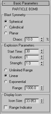

- On the Create panel, activate
(Space Warps). In the Forces category, click the PBomb button and drag in a viewport to create the PBomb icon.
- Use Bind to Space Warp to bind the PArray icon to the PBomb icon. (Don't bind the distribution object by mistake.)
- Select the PBomb icon and move to the Modify panel.
- In the Explosion Parameters group, set Blast Symmetry to Spherical, Start Time to 10, Duration to 1, and Strength to 1.0. Choose Linear, if it's not already chosen.
- Drag the time slider between frames 9 and 20 to see the effect.
- Go to frame 12 and try out various settings. Notice that increasing Strength expands the explosion effect at the current frame. If you decrease Range enough, the bomb no longer affects all or part of the object (depending on the placement of the PBomb icon). Test the three Blast Symmetry settings by placing the bomb in the center of the object and then seeing the different blast patterns.

Blast Symmetry group
These options specify the shape, or pattern of the blast effect.
- Spherical (The default) The blast force radiates outward from the PBomb icon in all directions. The icon looks like a spherical anarchist's bomb.
- Cylindrical The blast force radiates outward from and normal to the central axis, or core of the cylindrical icon. The icon looks like a stick of dynamite with a fuse.
- Planar The blast force radiates both up and down, perpendicular to the plane of the planar icon. The icon looks like a plane with arrows pointing up and down along the direction of the blast force.
- Chaos
- The blast forces vary for each particle or each frame, an effect similar to Brownian motion, with a rate of change in the direction of force equal to the rendering interval rate. Note: This setting is effective only when the Duration spinner is set to 0.
- Start Time
- The frame number at which the impulse forces are first applied to the particles.
- Duration
- The number of frames, beyond the first, over which the forces are applied. This value should typically be a small number, such as between 0 and 3.
- Strength
- The change in velocity along the blast vector, in units per frame. Increasing Strength increases the speed with which the particles are blown away from the bomb icon.
- Unlimited Range The effects of the bomb icon reach all bound particles throughout the scene. This option ignores the Range setting (which specifies the distance of the PBomb effect).
- Linear The impulse forces decay linearly between the full Strength setting to a value of 0 at the specified Range setting.
- Exponential The impulse forces decay exponentially between the full Strength setting to a value of 0 at the specified Range setting.
Range The maximum distance, in units, over which the PBomb icon affects the bound particle system. If the Range is large enough to reach only a portion of the particle system, only that part of the system is affected.
If you turn on Range Indicator (see following), the extent of the range is indicated by a tri-hooped sphere. If you choose Unlimited Range, this parameter has no effect.
