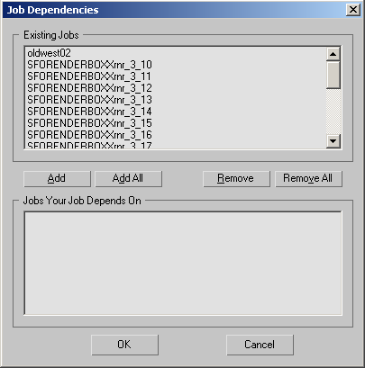

This dialog lets you specify jobs that shouldn't begin rendering until other jobs finish. Use the two lists and the Add and Remove buttons to build a list of jobs that must finish rendering before the current job can start.

Interface
Existing Jobs list
Lists all previously submitted jobs. To specify a dependency for the current job, add one or more of these to the Jobs Your Job Depends On list.
Add
Select one or more jobs your job is to depend on, and then click Add to add them to the Jobs Your Job Depends On list.
Add All
Adds all jobs in the Existing Jobs list to the Jobs Your Job Depends On list.
Remove
Removes highlighted jobs from the Jobs Your Job Depends On list.
Remove All
Removes all jobs from the Jobs Your Job Depends On list.
