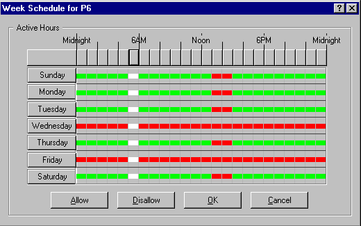

To schedule a set of active hours for a server or servers:
- In Queue Monitor's Server list, right-click a Server and choose Week Schedule, or select one or more Servers and choose Servers menu
Week Schedule. - In the dialog that appears, select a time using one of the following methods:
- Select a one-hour block for network rendering by clicking one of the top buttons.
- Select an entire day by clicking a side button.
- Select the entire week by clicking the large top-left button.
The selection is shown in white.
- Click the Allow button. The selection is shown in green. (By default, all hours are allowed).
- To apply the time selection to the selected Server, click OK.

- In Queue Monitor's Server list, right-click a Server and choose Week Schedule, or select a Server and choose Servers menu
- Click the Disallow button. The selection is shown in red.
