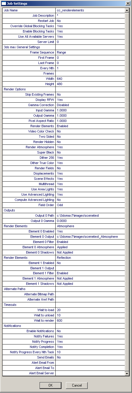

Use the Job Settings dialog to change job-related settings such as frame range, output size, and output directory, without having to use the Render Setup dialog and resubmit the job.
You can change job settings for a job while it's suspended or while it's rendering. By default in either case, after you click OK to exit the dialog, the rendering job restarts from the first frame. You can turn this feature off with the Restart Job option.
Most settings are either toggle switches or editable from the keyboard. To change a toggle setting, double-click its entry (in the right-hand column). If a setting is editable, its value turns green when you click it. To change an editable setting, click it to get the keyboard cursor, and then enter a new value from the keyboard. If you double-click the value when it's green, it highlights, and anything you type replaces it.

3ds Max General Settings group
- Frame Sequence
- This toggle setting alternates between Frames and Range, and, by default, uses the Range and Frames settings in the Render Setup dialog. When set to Range, the job uses the First/Last Frame and Every Nth settings; when set to Frames, the job uses the Frames setting. Toggled by double-clicking the entry. Default=Range.
- First Frame
- Displays the first frame in the range to be rendered. Defaults to the first frame as submitted. Editable from keyboard.
- Last Frame
- Displays the last frame in the range to be rendered. Defaults to the last frame as submitted. Editable from keyboard.
- Every Nth
- Regular sample of frames. For example, enter 8 to render every 8th frame. Editable from keyboard.
- Frames
- Non-sequential frames separated by commas (for example, 2,5) or ranges of frames separated by hyphens (for example, 0-5). Editable from keyboard.
- Width/Height
- Lets you set the resolution of the output image by specifying the width and the height of the image, in pixels. Defaults to the output size as submitted. Editable from keyboard.
