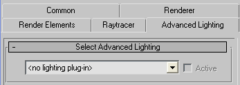

Until you choose an advanced lighting option, the Advanced Lighting panel displays a single rollout, Select Advanced Lighting.
List of plug-ins
Choose an advanced lighting option from this drop-down list. Default=No advanced lighting chosen.
Active
When an advanced lighting option is chosen, use Active to toggle whether the advanced lighting is used when you render your scene. Default=On.
