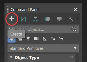

Found in the Command Panel, the Create panel provides the controls for creating objects. This is the first step in building a new scene in 3ds Max.
The Create panel in the Command panel.
