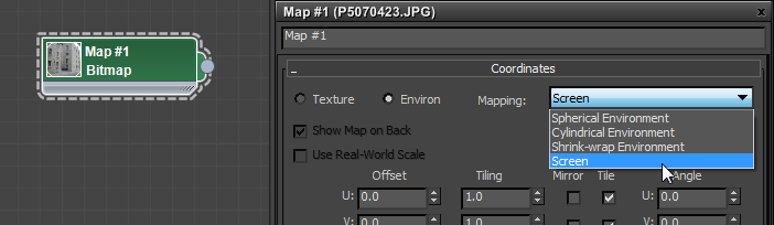

Background panel is not already open, open it and make sure Aspect Ratio is set to Match Rendering Output (this is the default choice). - Use the Material Editor to change the map's Mapping type to Screen.
To place the map in the Material Editor, open both the Material Editor and the Environment panel. Drag the Environment Map button and drop it on the active View (for the Slate Material Editor) or an unused sample slot (for the Compact Material Editor). When 3ds Max prompts you, be sure to choose Instance.
