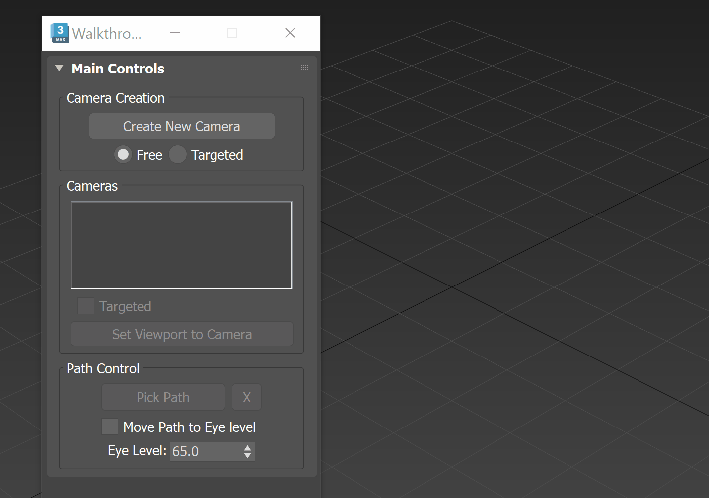

- On the Animation menu, choose Walkthrough Assistant.
The Walkthrough Assistant floater is displayed.
- Click the Create New Camera button on the Main Controls rollout.
3ds Max creates a free camera named Walkthrough_Cam01, and displays the new camera in the viewports. The camera is also listed by name in the Cameras list.
Click Create New Camera
If you can't see the camera in the viewport, zoom out to see it.
Additional rollouts are also displayed in the floater.
