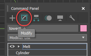

Found in the Command Panel, the Modify panel lets you change geometry parameters.
The Modify panel
- Command panel >
Modify panel
Each object you add has its own set of creation parameters, which define its geometry and other characteristics, depending on the type of object. Once placed in a scene, objects carry their creation parameters with them. You can change these parameters on the Modify panel.
You also use the Modify panel to assign modifiers to objects and adjust modifier settings. A modifier is typically a tool for reshaping an object. While they can mold the final appearance of an object, modifiers do not change its underlying creation parameters.
