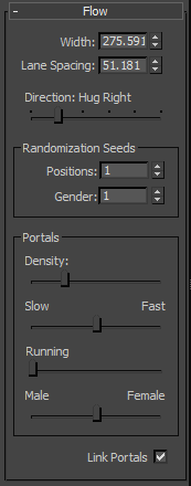

Flow Rollout (Populate)
Has controls for the behavior of flows.
  • Create or select a Populate flow. > Modify panel > Flow rollout
In Populate, a flow is a pathway along which simulated people walk or run. Visible features include lines that show lanes where people walk and markers that show each pedestrian's starting point, direction of travel, and gender: red for female and blue for male. Markers also appear at lane and ramp endpoints.
