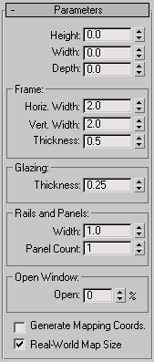

Parameters rollout
- Height/Width/Depth
Specifies the overall dimensions of the window.
Frame group
- Horiz. Width
Sets the width of the horizontal part of the window frame (at the top and bottom). This setting also affects the glazed portion of the window's width.
- Vert. Width
Sets the width of the vertical part of the window frame (at the sides). This setting also affects the glazed portion of the window's height.
- Thickness
Sets the thickness of the frame. This also controls the thickness of casements or railings on the window's sashes.
Glazing group
- Thickness
Specifies the thickness of the glass.
- Generate Mapping Coordinates
Creates the object with the appropriate mapping coordinates already applied.
- Real-World Map Size
Controls the scaling method used for texture mapped materials that are applied to the object. The scaling values are controlled by the Use Real-World Scale settings found in the applied material's Coordinates rollout. Default=off.
