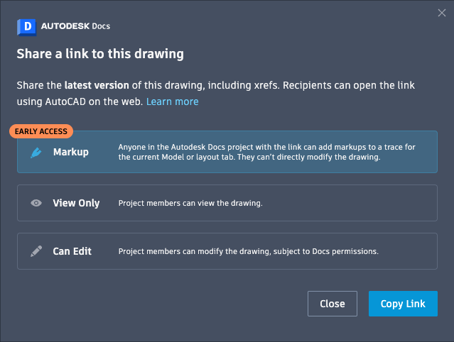

To Share a drawing for markups
  1. With the drawing open, click SHARE in the top-right above the drawing area.
  2. In the Share dialog, select Markup.
  3. Click Copy Link. This creates a new trace of the current Model or layout tab and saves the drawing.
  4. Share the URL with any collaborators who have access to the Autodesk Docs project.
Note: Sharing a link for markup creates a URL for the current tab (Model or layout). Each tab can have only one shared URL, meaning if you or another collaborator shares the link again from the same tab, it will generate the same URL as the initial share.
