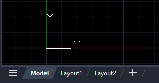

Have you ever wondered what that thing is in the lower left corner of the drawing area and curious about what it does? Or maybe you know it's the UCS (User Coordinate System) icon but because you don't create 3D models, you don't think it's useful for 2D work. Let's spend some time on what the UCS is and how you might use it in 2D drafting.
The UCS establishes the origin and orientation of a movable Cartesian coordinate system. By moving and changing the orientation of the UCS, you can relocate 0,0 of your drawing.
As you move the origin of the UCS, the drawing grid also moves and orients itself to the new origin. The main axis lines of the grid show the positive directions of the X (red line) and Y (green line) axis.
Note: By default, an angle of 0 degrees is always aligned to the UCS X axis regardless of its rotation.

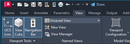

First, if the UCS icon is not displayed, turn it on by clicking the View tab and toggle the UCS icon control.
Note: You can also enter UCSICON at the Command prompt and choose On.
You should now see the UCS icon in the drawing area.
Let's also make sure the grid is turned on by clicking the grid icon on the status bar. This toggles the grid on or off.

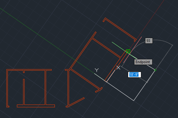

Now that the UCS icon is displayed it can be moved and rotated in the drawing. Moving and aligning the UCS icon is useful when you have an angled area of a drawing that you want to work on without having to continuously input the angle for each new line.
In this example, I'll align the UCS with the angled walls in this floor plan.
  1. Click the UCS icon.
  2. Click the move grip. The UCS icon should now be moving with the cursor.
  3. Drag it to the endpoint of the wall and use an Endpoint object snap to ensure proper placement.

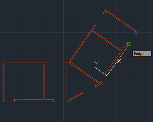

  4. With the UCS icon repositioned, click the round grip at the end of the x-axis and snap to the Endpoint of the wall.
    Along the x-axis of the UCS, you'll also notice that the cursor and grid lines are rotated to be parallel with the wall.
    Now, you can easily align all new lines to the rotated walls of the building.

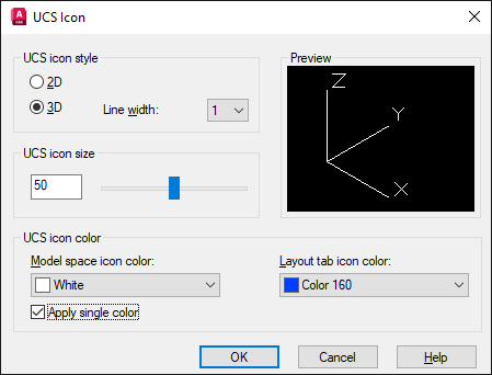

In addition to moving and orienting the UCS icon, the appearance can also be customized. Let's say you want to make the UCS icon larger or a different color. You can do this by right clicking on the UCS icon. From the shortcut menu, choose UCS Icon Settings > Properties.
Here you can set the icon style, size, color and other settings.
